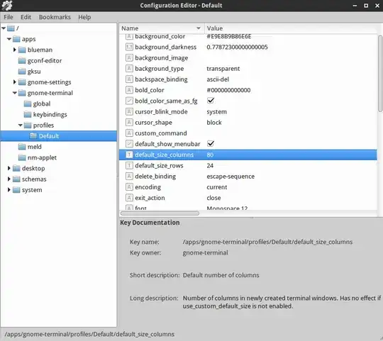

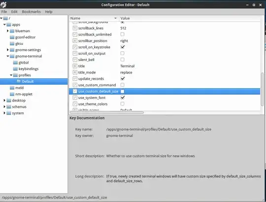

then you can find the settings here:
Set use_custom_default_siz to false.
Above in this window you will also find the two size values if you only want to change this:
