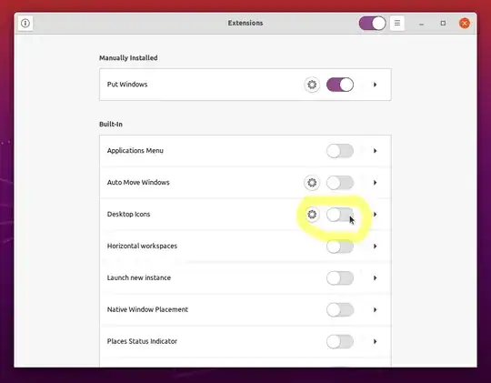

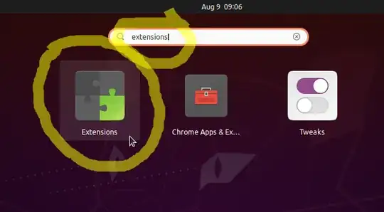

    You must also change a setting in the new "Extensions" program which we just installed (or "activated", maybe?--I'm not sure) above with sudo apt install gnome-tweak-tool. Press your Super key (Windows key on a PC keyboard, or Command key on a Mac running Linux), then type in "extensions", and click the Extensions program:
    Inside this program, click the slider to turn off "Desktop Icons", as shown below. This turns OFF the nautilus desktop icons so that we can just have the nemo desktop icons instead. If you don't do this, you'll get a weird desktop with unusable nautilus desktop icons covered up by usable nemo desktop icons, as shown a couple images down.

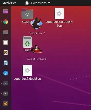

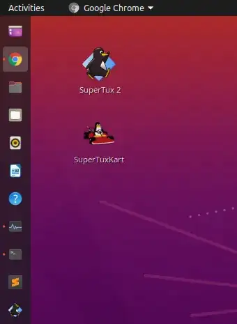

    Here's a snapshot of my desktop:
    Before:
    (Shows the newly-activated nemo desktop superimposed on top of the now-unusable nautilus desktop):
    After:
    (Now shows just the newly-activated nemo desktop, with the default Ubuntu gnome nautilus desktop icons now disabled, as I want):

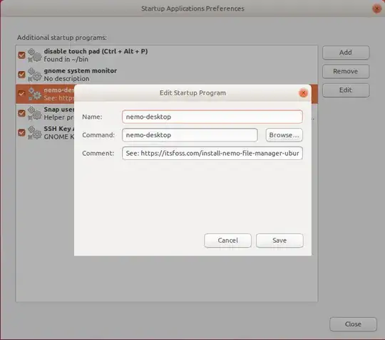

Now add the command nemo-desktop to your startup applications to turn on the nemo desktop icons at every boot.

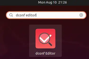

sudo apt install dconf-editor
Press your Super key (Windows key on a PC keyboard, or Command key on a Mac running Linux), then type in "dconf editor", and click the program:

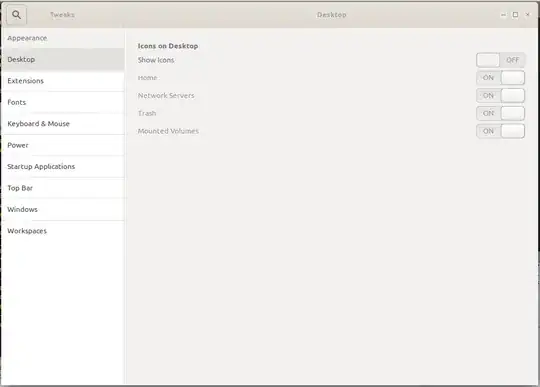

Then open it by searching for "Tweaks" in your start menu, and going to --> Desktop tab on left:

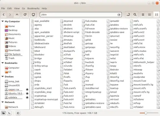

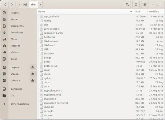

Why use nemo over Ubuntu's default nautilus file manager?
This one's easy. Take a look at the beautiful use of space that nemo permits in Compact view. Look at all of the files you can see at once!
(Note that this view is NOT zoomed out all the way. You can still zoom out one more time while still seeing the file names, and one more time after that to see only tiny icons). I LOVE how compact you can see everything! Let this be a model for GUI file manager designers (Microsoft & Apple & Ubuntu/Nautilus, take note! :))

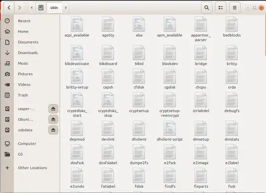

Versus the really user-unfriendly and space-wasting views available in the nautilus file manager (looking in the same directory in an identically-sized window):
  1. Icon view (zoomed all the way out):
  2. Or, list view (zoomed all the way out): enter image description here
Aweful, in my opinion! I can't see hardly any files in comparison and it's much more difficult to find things!
Enough said. Notice the nice address bar you can easily type in in nemo too. In nautilus you have to use Ctrl + L to see the address bar to type in.

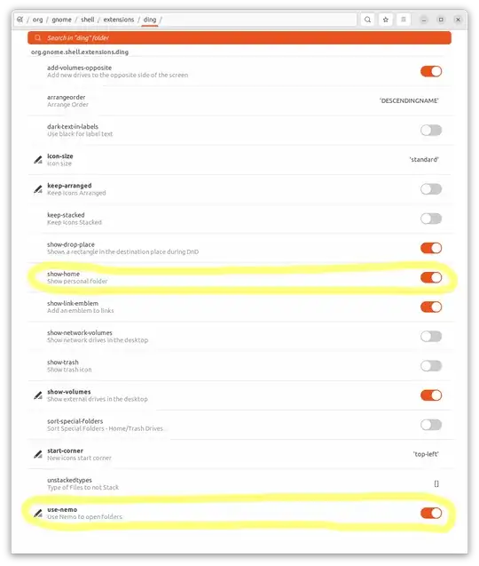

Open the dconf-editor tool, and navigate to org --> gnome--> shell --> extensions --> ding.
Turn on the "use-nemo" option at the bottom in order to "Use Nemo to open folders".
Here are my current settings:
Note that you can also edit these settings at the command-line. Example:
gsettings set org.gnome.shell.extensions.ding use-nemo true
gsettings set org.gnome.shell.extensions.ding show-home true
...and some of these settings are accessible via your main "Settings" menus as well.

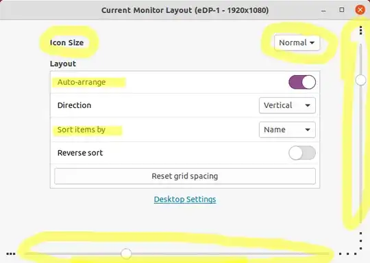

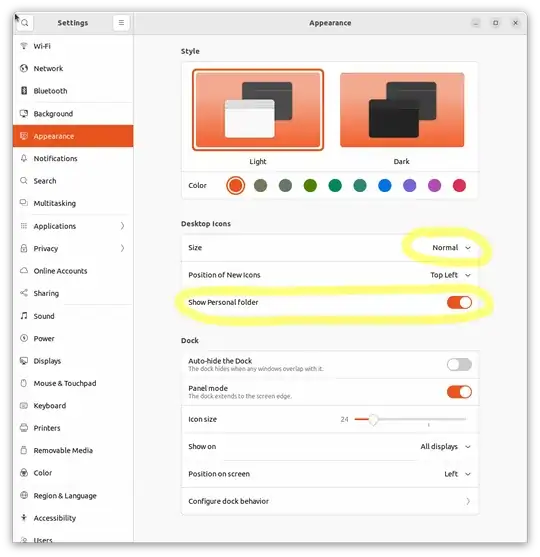

To change the desktop icon size:
Use the "Size" option under your regular Settings. It is found under Settings --> "Appearance" tab --> "Desktop Icons" section --> "Size" parameter, as shown in the last screenshot above. That is the recommended place to change it, but you can also access it via the dconf-editor at the screen shown above, or at the command-line via gsettings set org.gnome.shell.extensions.ding icon-size <size>, where size is apparently an enum value chosen from the range obtained by gsettings range org.gnome.shell.extensions.ding icon-size.

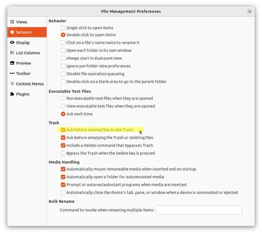

Other settings I like to set in Nemo:

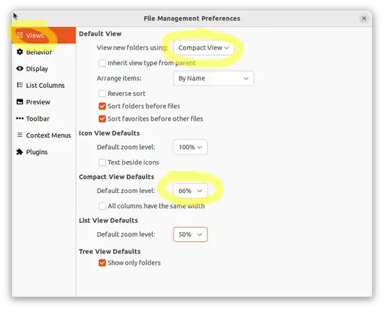

Choose View --> Compact View. Also ensure View --> Statusbar is checked. This shows the status bar at the bottom of the window.
Then go to Edit --> Preferences --> Views tab --> change the "Default View" to "Compact View", and reduce the "Compact View Defaults" "Default zoom level" from 100% to 66%, so you can see more files and folders in your Compact View. Here are my settings in this tab:
Under the "Behavior" tab, check the box for "Ask before moving files to the Trash":

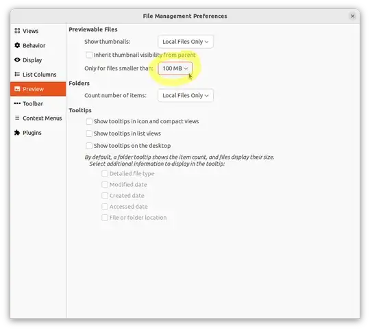

Turn on image thumbnail previews for larger images by going to the "Preview" tab and changing the file size from 1 MB to 100 MB or so:

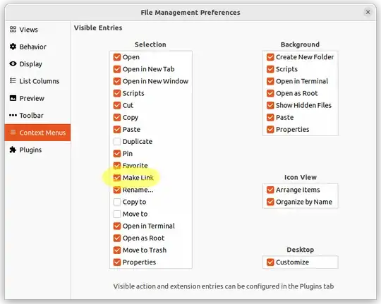

Under the "Context Menus" tab, check the box for "Make Link" (see screenshot below). This adds a "Make Link" menu option to the right-click menu in order to quickly make a symlink to the file or folder you have selected.
