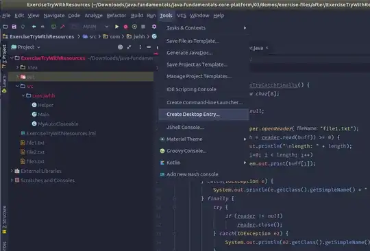

You haven't created two things:
  1. A terminal launcher, and
  2. An entry for the .desktop file.
Launch the apps like you did from their folders then in the menu go to the Tools menu and under it select Create Command-line launcher and Create Desktop Entry respectively. Now you should see the icons to launch the apps.
options dialog
