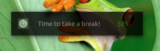

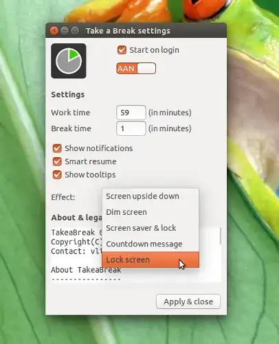

TakeaBreak
TakeaBreak is now on launchpad
sudo add-apt-repository ppa:vlijm/takeabreak
sudo apt-get update
sudo apt-get install takeabreak
Recently (also) pushed for 18.04 / 18.10 / 19.04
Disclaimer: I am the author
Feel free to file bugs etc. here, or comment here. Thanks to orschiro for the nice question, and Rinzwind for the encouragement!
remaining break- seconds (using countdown- option)
Settings
EDIT

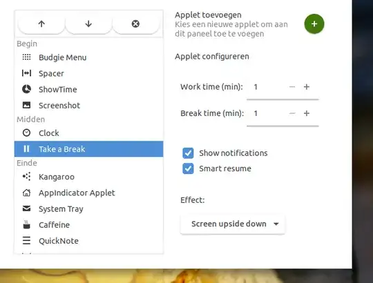

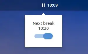

An integrated & modernized version for Ubuntu Budgie is now available:
This applet will most likely be available by default in Ubuntu Budgie 19.04, but can now be achieved here as an experimental one.

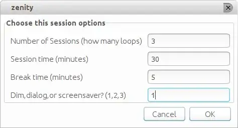

Below is a script for a timer that allows setting variable session and break time, as well as methods of signalling the break.
Remember that any script on linux must be saved as a file and have executable permissions set with chmod +x /path/to/script.sh. Once that is done, you can bind the script to a shortcut as show in How do I bind .sh files to keyboard combination? or create a desktop shortcut as shown in How can I create launchers on my desktop?
When you launch the script you should see a menu like this:
