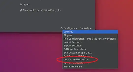

It is quite simple, in the main menu before opening a project there is a quick setting which will add IntelliJ as shortcut in Ubuntu. Go to "Configure" in the lower right corner and then select "Create Desktop entry".
Picture showing how to create a shortcut on Ubuntu

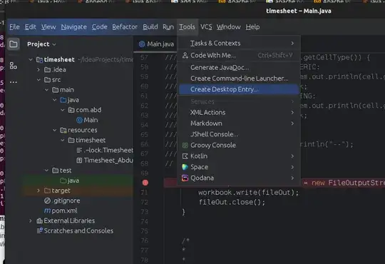

For recent versions of Idea(~2024) the options are here
