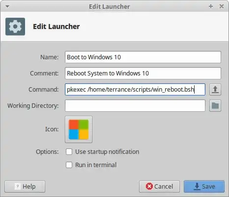

Create a shortcut to the new script. I hope that when you right-click on your desktop that Create Launcher is one of the options. I am running Xfce4 as my desktop. I guess you could create a launcher based on the comment posted by Andrew Shum as it should still work as long as it points to the win_reboot.bsh script.
Edit: I changed the launcher here based on the comments I received below. sudo -H does not work in the command of a launcher, unless you have set the option to Run in Terminal. One other thing to note here that this launcher is calling a CLI script and not a GUI application.
You can create a file in your ~/Desktop folder named Boot to Windows 10.desktop and add the following to it:

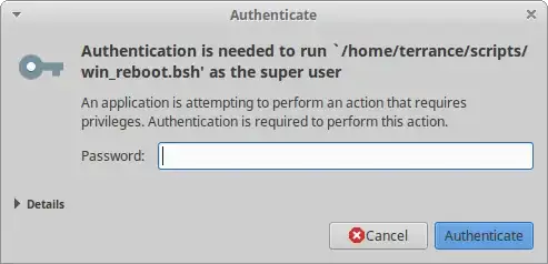

Then when you launch the shortcut you will see something similar to enter your password as the Super User:
