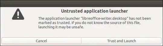

  3. The launcher looks weird, but that will be fixed in a moment. In Ubuntu 18.04, double-click the launcher. You will get a warning dialog:
  1. Select "Trust and Launch". Now, the launcher will be turned into a normal, working launcher with the correct icon. Ubuntu 19.10 users should right-click the launcher on the desktop and then select "Allow launching".
