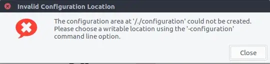

The problem is that whenever I try to run the application I get this error:
Clicking on the executable directly launches the application normally and the error is the same regardless of who owns the file (root or user) so I don't understand what I'm doing wrong. Any advice would be great.

Update:
Running ./XMind from the terminal works as expected.
Running the whole path /home/user01/.installed/xmind-8-linux/XMind_amd64/XMind creates an error.
When the error happens the application creates a configuration folder in ~/ directory, which is normally located in the same folder as the executable. I still don't understand what's happening here.

When you run it as ./Xmind, your current directory is the same directory as the Xmind executable. To duplicate that effect in a .desktop file, add a Path= line to set the working directory:
Path=/home/user01/.installed/xmind-8-linux/XMind_amd64/
For more information, see the .desktop file specification on what the Path entry does.
I'd also recommend moving the .desktop file from /usr/share/applications to /home/user01/.local/share/applications/, since, if you store the application within your home directory, it's probably an application just for you, rather than all users on the system.

It seems that Xmind will attempt to create a folder in the place it is executed from. You will have to tell the .desktop file to move to that location before executing it. From this post, try something like this:
Exec=bash -c "export PATH=$PATH:`dirname %k`; your_command"
