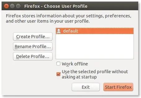

    Firefox ProfileManager main window
  • Rename your current profile default to profile1 (or whatever you like, you don't even have to rename it, but I will do in this guide for clarification - you just have to replace profile1 with your exact name wherever it occurs!) by clicking on Rename Profile....

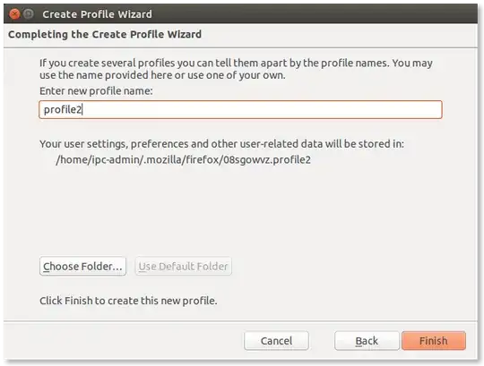

  • Create a new profile with the wizard by clicking on Create Profile.... It will show you an info window first, read it and click Next. The second window will ask you to enter a name for the profile, enter profile2 here (or replace it wherever it occurs in this guide with exactly what you entered instead). I would recommend you not to change the folder where the profile will be stored in, unless you have a good reason to do so. Click Finish.
    Firefox ProfileManager Create Profile wizard

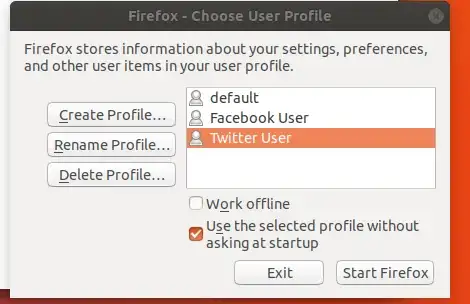

I think Firefox Profile Switcher is your answer!
You can activate it with the option "-P" like this on the commandline
firefox -P
You can then create Profiles for each task, all in the same homefolder (if you must).
firefox profiles

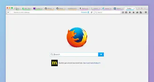

I would propose the Multi-Account Containers extension, an official Mozilla-made addon. The use-case you described is precisely why it exists:
Screenshot from AMO
(source: mozilla.net)
She can create containers for each one of her account sets, and choose an accent color. This accent color will show up below the title of every tab, indicating which container it is on:
Three tabs on three containers (nevermind the dark theme)
Tabs by default do not open in a container, you create them by long-pressing the "new tab" button.
Not only are the containers easily identified, tabs are just normal tabs, you can put them all on the same window. (with multiple profiles, you would not be able to have tabs of 2 profiles in one window).

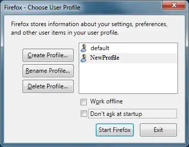

Run firefox -P or firefox -ProfileManager.
You may then create, select, and manage your profile(s).
ff profile
See also How to create a new Firefox profile on Windows? (kb.mozillazine.org).

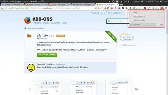

The easiest way to manage profiles in firefox is installing the multifox addon.
URL: https://addons.mozilla.org/en-US/firefox/addon/multifox/
It works like profiles in Chrome but more smooth and better.
You can open up different tabs of the same site with different logged in users.
See attached:
