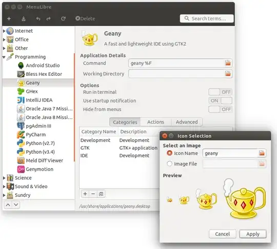

I must have read this question dozen times, everytime I install Ubuntu on another computer :)
The easiest way to add a custom launcher is using a GUI tool.
There are at least two I know of:
  • MenuLibre - my new favourite :)
  • Alacarte - the one I used for years, but now has bugs
Installation
MenuLibre can be installed by running following command in your terminal:
sudo apt install menulibre
or simply search the Software Center for menulibre and install from there.
Likewise, to install alacarte run:
sudo apt install alacarte
or search the Software Center for alacarte.
You only need one,so make a choice and you will be adding launchers in no time!
Last but not least, here is a picture ( worth at least a thousand words )
Alacarte looks simmilar but is simpler and less advanced.
Now about those bugs I mentioned: Alacarte now has isues with PNG icons, so even though it makes you believe it is adding the icon they don't save and you launchers will be icon-less.

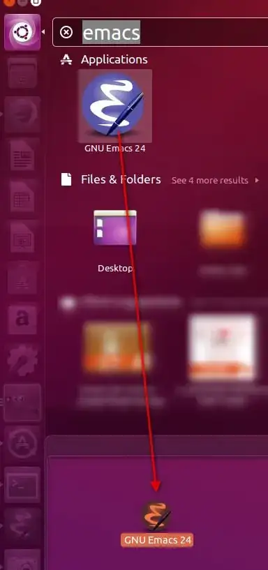

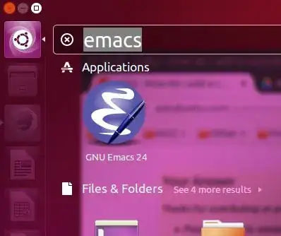

Open the Dash by pressing the Windows Key, which on my keyboard, is mapped to the Super_L key (reported by xev program). Once in the Dashboard, type the name of some program. In this example, I typed emacs because I want a launcher that launches Emacs, but instead runs a script I have that sets up some environment and then executes Emacs:
Dash with Emacs
Drag the icon to the desktop:
Drag Emacs icon to desktop

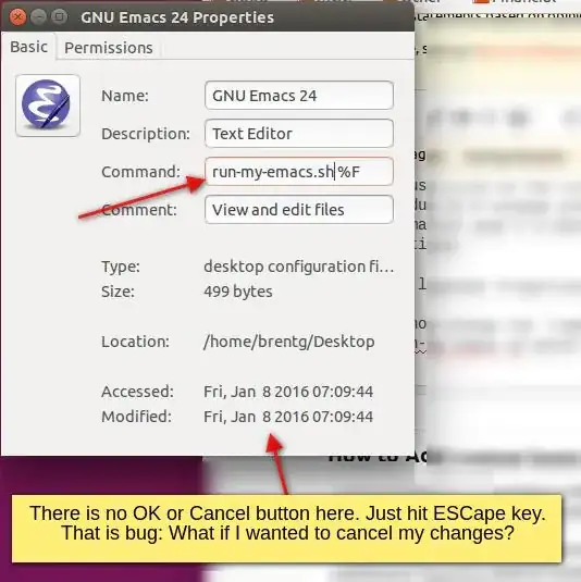

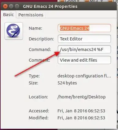

Right mouse click on the icon on the desktop, and then click on Properties (sorry, due to X windows grabbing, I cannot provide a screen-shot of that menu no matter what I tried!). This is what you might see before making modifications:
Emacs launcher Properties before changing
You can now change the Command to whatever you want. In my case I changed it to run-my-emacs.sh, which happens to be in my PATH, which I have previously set up in my startup scripts:
Emacs launcher Properties after changing
Click ESCape key to exit after making changes. Do note the bug in the screenshot above.
Double check that it works by double-clicking the icon on the desktop.

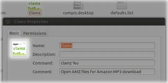

In case you just want to change an icon to other than default you can do so by opening the Preferences menu with a right click on the .desktop file. This will show the following dialog:
Click on the icon to open a file selector box to give a new icon path.
Local .desktop files can be found in ~/.local/share/applications/, custom icons may be stored in ~/.icons/.
Only icons from .desktop files having executable permission will be shown.

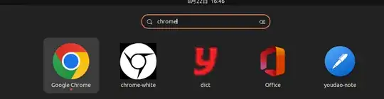

A google-chrome app example, tested on Ubuntu 22.04
  1. download a icon for the app, save at /home/xxx/note.png
  2. create file: ~/.local/share/applications/chrome-youdao-note.desktop
[Desktop Entry]
Type=Application
Name=youdao-note
Exec=google-chrome --app=http://note.youdao.com --new-window
Icon=/home/xxx/note.png
Terminal=false
StartupNotify=true
  1. search chrome in launcher enter image description here
