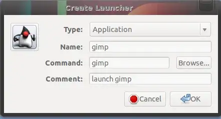

I just installed GIMP and Mumble and many other things from Synaptic and now my sidebar is getting a bit cluttered. I want to put GIMP and other apps on my desktop not my side-bar. I also know that I can make a shell script to run it and add a picture to it but I dont really want to do that just have the whole app on the desktop.
Thers is a very easy way to do so for any and all programs.
Just copy the below command and paste in a new file naming somthing.sh
gnome-desktop-item-edit --create-new ~/Desktop
Now edit properties of the file and make it executable. And thats it you are done with your custom-desktop-launcher-maker
Now double click on the file and click onRun in terminal on prompt. You will be greeted with a window similar to this enter image description here
Enter the command for the application you want to make a launcher in the command field. you can fill other as to your desire. You can also choose your icon. and after finishing hit ok. thats it!
SEE YOUR DESKTOP
Hope it helps.
