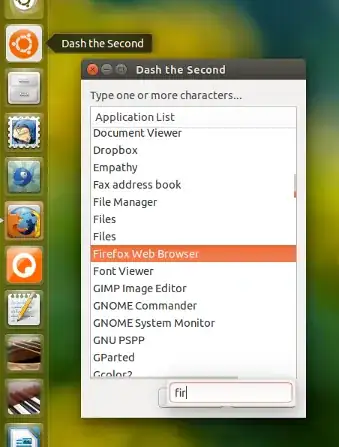

1. Dash the Second
Below a script that can be used as an alternative to Dash, when it comes to running applications as described in your question.
It exists of a window with the same functionality as Dash; if type one or more characters of the application, the application will appear in the list. Press Enter to either start or raise the application, depending on if it is already running or not.
You can call it from a shortcut key combination, or set an icon in the launcher to use it similarly to Dash (see further below), or both.

How to use
The script needs wmctrl installed:
sudo apt-get install wmctrl
Then:
  1. Paste the script above into an empty file, save it as dash_alternative.py
  2. Add it to a shortcut key combination: Choose: System Settings > "Keyboard" > "Shortcuts" > "Custom Shortcuts". Click the "+" and add the command:
    python3 /path/to/dash_alternative.py
Explanation
When the script is run, It lists all applications, represented in /usr/share/applications. It searches the .dektop files, creating a list of all application names (from the first "Name=" line) and the command to run the application (from the first "Exec=" line).
Subsequently, a Zenity list is created, presenting all applications in a sorted manner.
Whenever an application is selected, the script looks in the list of running processes if the application is running. If so, the corresponding window is raised. If not, a new instance is opened.

2. Additional: setting it as an alternative to the "real" Dash for running applications
  1. Copy and safe the script as mentioned above
  3. Copy the code below into an empty file, save it in ~/.local/share/applications as dash_thesecond.desktop. Set the correct paths for /path/to/dash_alternative.py (the script) and /path/to/dash_alternative.png (the icon)
    [Desktop Entry]
    Name=Dash the Second
    Exec=python3 /path/to/dash_alternative.py
    Icon=/path/to/dash_alternative.png
    Type=Application
    Hidden=false
  4. Drag the .desktop file on to the launcher:
