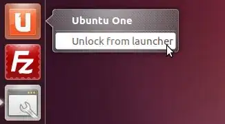

I'm maintaining the PC of an old relative. The person shall not have the possibility to unlock a Launcher-Icon by means of "Unlock from launcher" in the Quicklist (in former Ubuntu versions it was named uncheck "Keep in Launcher").
Is it possible to remove or disable (greyed out) "Unlock from launcher" in the Quicklist of a Launcher-Icon?

It seems there exists no way to remove or disable “Unlock from launcher” in the Quicklist of a Launcher-Icon.
But I found a workaround that saves the current order of the icons in the Launcher and - in the case that an icon was mistakenly removed from the Launcher - restores the order after every start, reboot or login.
Step 1: Save the current order of the icons in the Launcher: Start Terminal (Ctrl+Alt+T) and enter the command gsettings get com.canonical.Unity.Launcher favorites > starter.icons (this will save the order in the file starter.icons in your home-directory).
