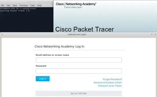

packettracer
Cisco Packet Tracer will open and Cisco username and password will be requested.
