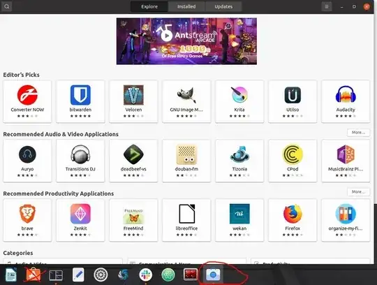

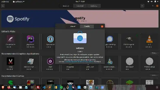

Is that gnome-software (see icon below)
screenshot
(If you hover your mouse over this on your dock/taskbar you get the tooltop Software. I didn't have this one docked to my taskbar on a fresh Ubuntu 20 installation.)
or snap-store? (see icon below)
screenshot
(the tooltip for this is Ubuntu Software).
