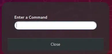

After upgrading to Ubuntu 18.04, I can't find xkill on pressing Alt+F2. Instead it shows a message box with a text-field titled as Enter a Command.
How can I find xkill on Ubuntu 18.04 and what is the purpose of this new window?

You need to type xkill in Enter a command prompt and hit Enter.

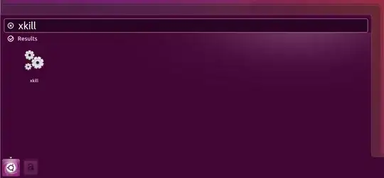

Unity used to have this kind of interface when Alt+F2 was used:
That was basically interface for entering a command with label Run a Command and Not a Dashboard(However it seems to be and that's what you are referring to.). It used to show suggestions as you type.
But in GNOME interface is like this:
And yes this doesn't show any sort of suggestions.

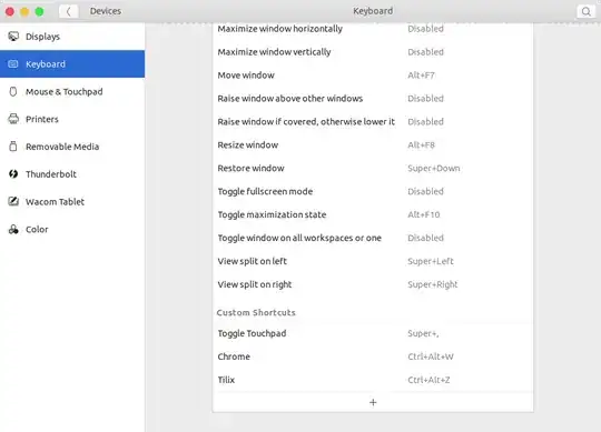

You can either create a Desktop Entry or define a keyboard shortcut in Settings → Devices → Keyboard to use xkill quickly.
The package involving xkill is x11-utils. If not already installed:
sudo apt install x11-utils
Now press Super+A and type xkill Enter.
Or set a new keybinding in Settings -> Devices -> Keyboard
