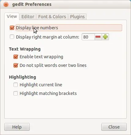

Please try to edit your sources.list file by dropping sudo gedit /etc/apt/sources.list in a terminal (your password may be asked), after which you will have the options to enable "Line Numbers" in the Menu Edit/Preferences of gEdit and clicking the "Display line numbers" checkbox, then manually go to the Line in your error e.g. 91 or by using "Search/Go to line" (Ctrl+I does the trick).
At the beginning of the Line 91 drop two # symbols (##) to comment on that line and this way remove it from the update process (you can also delete that line at your own risk, I suggest you a backup).
When you finish, save the file and close it down. Then open a terminal and run sudo apt-get update and see if the error still appears. If not, then try opening your update manager.
Somehow it seems that the text in the Line 91 of your sources.list file is corrupted or there is some kind of an error, which means that some software is unable to be installed/updated/upgraded.
By commenting/removing the erroneous line the software won't be installed (if not already) or won't be updated/upgraded if that's what you try. Of which I suggest you to check where is that line coming from (which software requires it) and do the proper modifications as required in order to everything run fine.
