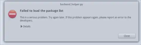

Another thing when I check for updates. I get this. enter image description here
sudo sed -i 's/ ain/ main/g' /etc/apt/sources.list.d/gwendal-lebihan-dev-cinnamon-stable-precise.list; sudo apt-get update
I'm assuming there is a typo in the script which says ain instead of main. The above will replace any instance of ' ain' with ' main' and update.
