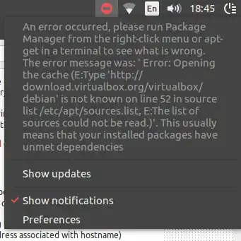

I have Ubuntu 16.04 LTS and tried to install Virtual Box on my system. I downloaded setup for 16.04 directly from Oracle site, ran through Ubuntu Software of course, and I suspected already when it didn't start install on one click, I needed to click twice, then I got install icon on my dock, which didn't load for about 10 minutes. I restarted, then I got error message on picture.
  • Question 1: How to fix that error?
  • Question 2: How do I get clear install of Virtual Box?
Apt error message

The line 52 of your /etc/apt/sources.list is wrong.
My guess being the deb prefix is missing.
Look at how the other (uncommented) lines are formatted.
Note: VirtualBox should be available using Ubuntu official repositories. You shouldn't need to install Oracle repository.
