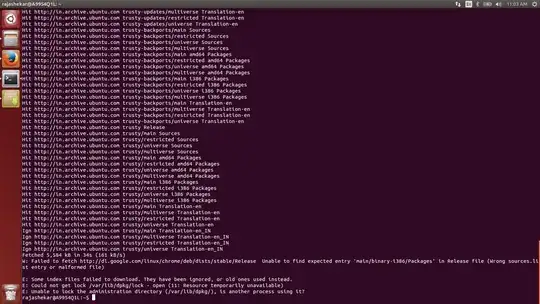

While installing Google Chrome in my Ubuntu OS I'm getting the below error while updating.
Please find the attachment for error
carnendil
  • 5,529
-1
You can delete the lock file with the following command:
sudo rm /var/lib/apt/lists/lock
You may also need to delete the lock file in the cache directory
sudo rm /var/cache/apt/archives/lock
