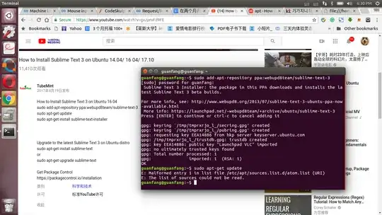

I tried methods like deleting or updating the source list that I found on the web but these didn't fix it.
screenshot, malformed entry in atom list, no further output from sudo apt-get update

in your case it seems that you just have to remove the atom source list
sudo rm -f /etc/apt/sources.list.d/atom.list
sudo apt-get update
if you want the atom txt editor to be installed/updated, follow the link: https://launchpad.net/~webupd8team/+archive/ubuntu/atom?field.series_filter=trusty
