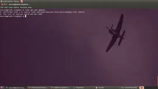

When I'm trying to update ubuntu 14.04 LTS, I got this error message:
E: Malformed line 1 in source list /etc/apt/sources.list.d/virtualbox.list (dist)
E: The list of sources could not be read.
screenshot
Contents of /etc/apt/sources.list.d/virtualbox.list:
deb download.virtualbox.org/virtualbox/debian trusty contrib non-free

just add
http://
edit it like this deb http://download.virtualbox.org/virtualbox/debian trusty contrib non-free
then sudo apt-get update and if that doesn't fix which it should then just delete the file from the sources.list.d directory dont worry it wont effect anything.
