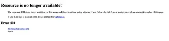

Visiting the URL you provided for the repository in a browser results in this response:
Resource is no longer available!
As a result, there's little chance of installing Albert from that location.
