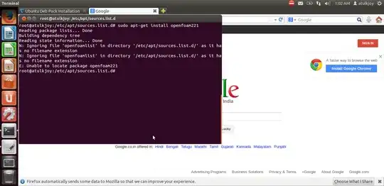

While I am executing command
**VERS=$(lsb_release -cs)
sudo sh -c "echo deb http://www.openfoam.org/download/ubuntu $VERS main > /etc/apt**/sources.list.d/openfoam.list"*][1]*
I have a file openfoam.list But output of sudo apt-get install openfoam221 is
N: Ignoring file 'openfoam221_0-1_i386.deb' in directory '/etc/apt/sources.list.d/' as it has an invalid filename extension
N: Ignoring file 'openfoamlist' in directory '/etc/apt/sources.list.d/' as it has no filename extension
E: Unable to locate package openfoam221

Ok, I really would love that you explain a bit what are you trying to do, but lets cleanup the mess:
sudo rm /etc/apt/sources.list.d/openfoam*
Now, I'm assuming that somewhere you are typing bad something, here is how is being done:
sudo sh -c "echo deb http://www.openfoam.org/download/ubuntu $(lsb_release -cs) main > /etc/apt/sources.list.d/openfoam.list"
Now lets check the file using cat:
braiam@bt:~$ cat /etc/apt/sources.list.d/openfoam.list
deb http://www.openfoam.org/download/ubuntu raring main
Now everything is ok, you can update and install whatever you want.
sudo apt-get update
