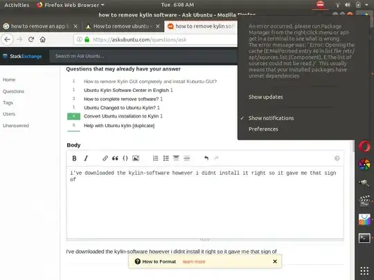

i've downloaded the kylin-software. However I didn't install it right so it gave me this sign:
Now i cant find it anywhere and though i cant remove it as well as that Chinese dialog box keeps popping up every time i open or restart my device . I've tried to use the terminal with some of the suggestions to get it or remove it but the file isn't readable to remove or do anything![ The list of sources could not be read.]

from Software & updates > other Software " found additional unclassified source codes that was the reason for the error" deleted them by clicking on remove button. restarted the system. made Ubuntu OS updates. then the UK kylin-software-center popped up again in Ubuntu-software. I removed it by clicking Remove button. then reinstalled it from the website itself www.ubuntukylin.com , the website is Chinese already so using some website translator would help to be more selective, and so i was able to choose the language of the appSoftware i prefer .but actually the kylin-software-center wasn't that helpful as i expected for 18.04.1 LTS
