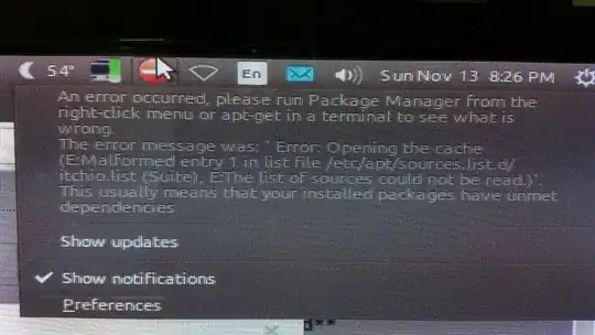

Not sure what to do from here.
I really don't care if I get rid of the update or get it I just want this annoying red dot gone. I know that I can not show notifications but I want them.
I did what the notification told me to do but I was unable to remove or update the file. Any help would be greatly appreciated.

According to the error message, the problem is caused by something in the file /etc/apt/sources.list.d/itchio.list
I'm assuming this is part of itch.io. You have a few options:
  • Remove itch.io using the appropriate method for doing so. If this involves removing a package, you may need to purge the package rather than just removing it.
  • Edit the above file to identify where the problem is (it's in the first entry) and try and fix it.
  • Contact the makers of itch.io for help with the problem.
