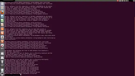

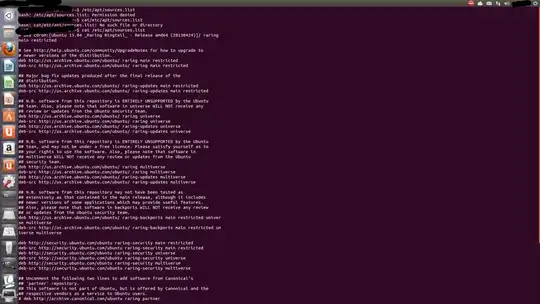

Update 2: When I typed in cat /etc/apt/sources.list, All I got back was:
