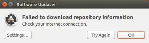

I run Ubuntu 14.04LTS, 64bit. I tried to run Software Updater, but I had that "Failed to download respository information. Check your Internet connection" message (screenshot).
I ran apt-get update, and it gave me this :

I tried to change the mirror server to several others, including "Main server", but the result is the same. The error seems to come from /etc/apt/sources.list or from /etc/apt/sources.list.d/*.

I also unchecked all "Other Software" boxes in "Software & Updates" program, just to see if the problem comes from an unofficial packet, but it seems not. Any idea to solve it ?

Use in terminal this line:
sudo sed -i 's/\ non-free//' /etc/apt/sources.list
this will change the following lines in /etc/apt/sources.list and leave out the non-free so they look like this:
deb http://us.archive.ubuntu.com/ubuntu/ trusty main restricted
deb http://us.archive.ubuntu.com/ubuntu/ trusty-updates multiverse main restricted universe
deb http://security.ubuntu.com/ubuntu/ trusty-security multiverse main restricted universe
deb http://us.archive.ubuntu.com/ubuntu/ trusty-backports multiverse main restricted universe
this should solve your issue.

non-free is not an Ubuntu component. That's Debian. The Ubuntu equivalents are restricted and multiverse. Ubuntu just has main, restricted, universe and multiverse.
