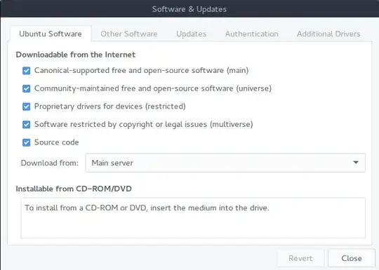

If you have a corrupted sources.list file. You could try this:
Remove the corrupted file:
sudo rm /etc/apt/sources.list
sudo software-properties-gtk
Then tick all the boxes, and change the 'Download from' server, this will create a new sources.list.
Then add any additional repos as needed.
This worked for me.
