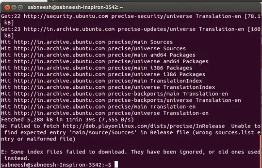

I entered sudo apt-get update in Terminal and got the following output
What to do now?

Execute
sudo sed -i '/playonlinux/d' /etc/apt/sources.list
to remove the wrong entry in sources.list and add the repository:
wget -q "http://deb.playonlinux.com/public.gpg" -O- | sudo apt-key add -
sudo wget http://deb.playonlinux.com/playonlinux_precise.list -O /etc/apt/sources.list.d/playonlinux.list
sudo apt-get update
