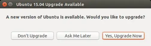

Every time I reboot my fully updated laptop running Ubuntu 14.04 amd64 I am greeted with this dialogue window at login:
Ubuntu 15.04 Upgrade Available Dialogue Window

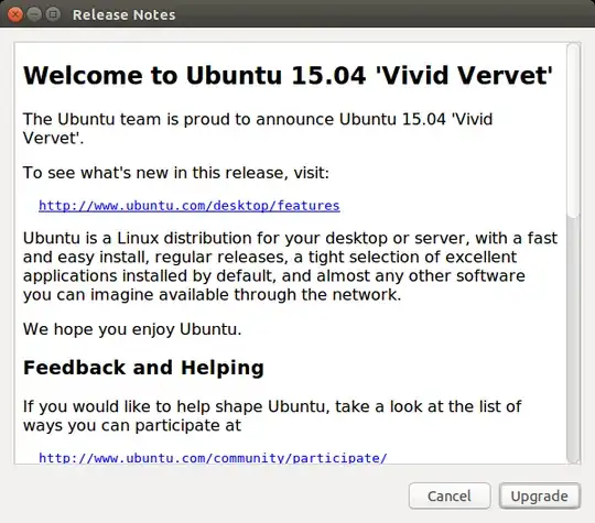

When I press the "Yes, Upgrade Now" button I see this very promising dialogue:
Release Notes: Welcome to Ubuntu 15.04 'Vivid Vervet'
EDIT: This is not a promising dialogue after all! The suggested upgrade path 14.04 -> 15.04 is not possible. Instead it should suggest 14.10 or next LTS. Please see the bug that I posted about this here.

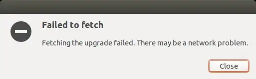

But when I press the "Upgrade" button and type in my password I see this:
Failed to fetch: Fetching the upgrade failed. There may be a network problem.
I can with 100% confidence say that there is no network problem (I am listening to an internet radio station while writing this in my browser).

It seems that my apt-cacher install was getting in the way.
I simply removed my /etc/apt/apt.conf.d/01proxy, then proceeded to run
apt-get update
apt-get upgrade
apt-get dist-upgrade
and finally when running
do-release-upgrade
it stopped whining about this:
403 Sorry, not allowed to fetch that type of file: vivid.tar.gz.gpg
NOTE: your proxy settings might be different than mine. Look for the file inside /etc/apt/apt.conf.d/ that contains the string proxy.
