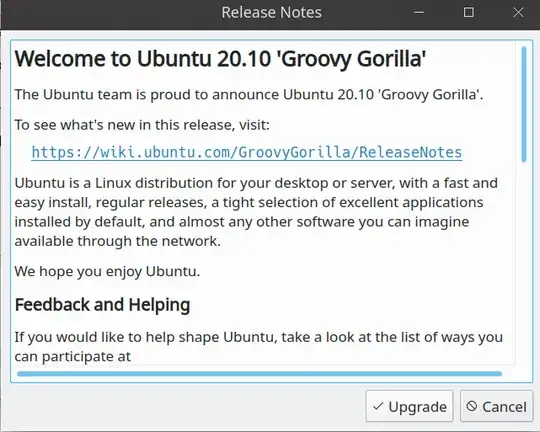

Running pkexec do-release-upgrade -m desktop -f DistUpgradeViewKDE I get the option to upgrade to 21.10.

authenticate 'groovy.tar.gz' against 'groovy.tar.gz.gpg'
extracting 'groovy.tar.gz'
I guess that should say hirsute instead of groovy.
How to upgrade to latest 21.04 directly?

There is no tested, supported upgrade path from 20.04 to 21.04.
You have three options:
  1. Release-upgrade from 20.04 and 20.10, then again from 20.10 to 21.04.
  2. Back up your data and clean-install 21.04.
  3. Use the Debian dist-upgrade method. We do not test that method, nor provide support if you break your system using it, so I'm not going to explain it.
Mark your calendar: 21.04 will live for only 9 months. You are committing to upgrades every 6 months when you migrate to a non-LTS release. Do not miss the upgrade window.
