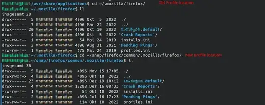

If so you can still transfer your Firefox and Thunderbird profiles. Only the places where the profiles are stored have changed because this programms are now installed using "Snaps" instead of "Deb-Files" .
  • Firefox changed from /home/yourname/.mozilla/firefox to /home/yourname/snap/firefox/common/.mozilla/firefox
  • Thunderbird changed from /home/yourname/.thunderbird to /home/yourname/snap/thunderbird/common/.thunderbird

On your old system:
Open a terminal (CTRL + ALT + t).
Find your Thunderbird and Firefox data folders in your /home directory:
find ~/ -name "*.default" -type d
On my computer I got the following result:
/home/digijay/.mozilla/firefox/wE1rdCh4.default
/home/digijay/.thunderbird/0th4wRdc.default
Copy these files to a save location, e.g. a usb drive:
cp -r ~/.mozilla/firefox/wE1rdCh4.default ~/.thunderbird/0th4wRdc.default /media/digijay/myusbdrive/
Make sure that you don't get any errors to prevent data loss! At least check that both folders are on the usb key. In my case I used rsync to copy the folders which is a little saver than cp imo.
On your new system:
You will have to install (or have already installed) the snap images of Firefox and Thunderbird. To use your old data there insert your usb drive and copy the folders from your usb drive to the following locations:
cp -r /media/digijay/myusbdrive/.mozilla/firefox/wE1rdCh4.default ~/snap/firefox/common/
cp -r /media/digijay/myusbdrive/.thunderbird/0th4wRdc.default ~/snap/thunderbird/common/
Start both snap apps and check if everything is there as expected (browser history and bookmarks, old mails and addressbooks).
I migrated my data in this way a while back and it worked well. Should you happen to have more than one email adress configured in Thunderbird (as in my case) copy all profile folders to ~/snap/thunderbird/common/
