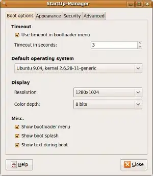

Also, there seems to be some graphical utility called StartUpManager which allows to set the menu timeout and other settings:
StartUpManager
