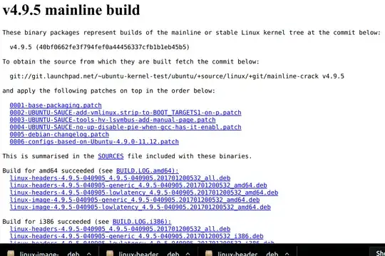

Easiest way to install newest kernel
I used to use wget as you did because those are popular / common instructions on the internet. It requires a little bit of typing and joining of strings though. An easier way is just to navigate to:
http://kernel.ubuntu.com/~kernel-ppa/mainline/
Press the End key and click on 4.9.5 or the newest kernel you want. Then this screen appears:
kernel 4.9.5
Assuming yoyu want 64-bit generic version click on:
  • linux-headers-4.9.5-040905_4.9.5-040905.201701200532_all.deb
  • linux-headers-4.9.5-040905-generic_4.9.5-040905.201701200532_amd64.deb
  • linux-image-4.9.5-040905-generic_4.9.5-040905.201701200532_amd64.deb
All three downloads will easily start for you without complicated typing.
When done open terminal with Ctrl+Alt+T and type:
cd Downloads
sudo dpkg -i *.deb
rm *4.9.5*
I think everyone will find this method much easier than methods commonly published on the internet.
