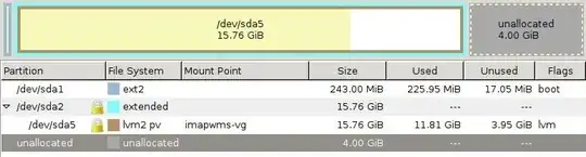

I have a Ubuntu server where my boot partition needs to be expanded:
GParted partition view
The server is virtual and running on VMWare. I have booted from the GParted LIVE CD (version 0.27.0) but GParted doesn't let me resize the partitions.
If I understand correctly I need to move some of the 4GB unallocated space (equal to the size I would like to expand the boot partition with) so it is located just right of the boot partition.
The yellow locks in the image appearently means that the partition /dev/sda5 is mounted, but I don't understand by who and why - since I'm booting from a LIVE CD.

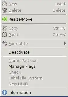

GParted allows me to click deactivate on /dev/sda5 but it doesn't change anything:
Right click menu with deactivate option
In the end I would like to expand /dev/sda5 to take up the remaining unallocated space, but the first step is to expand the boot partition.
How can I expand the boot partition?

I faced the exact same problem, came across this post, and solved it. I did the following with a 16.04.3 live CD:
  1. Used KDE Partition Manager to expand /dev/sda2 to the end of the drive
  2. Used KDE Partition Manager to move /dev/sda5 to the end of the drive
  3. Tried to use KDE Partition Manager to squeeze out the empty space on the left side of /dev/sda2, but failed. It wanted to first move /dev/sda2 to the right and then chop off an equal amount of space from the right side of /dev/sda2 but there was no room on the drive to do so.
  4. Used gparted to squeeze out the empty space on the left side of /dev/sda2.
  5. Used gparted to grow /dev/sda1 and occupy the whole space.
It worked without updating grub.
Notes:
  1. /dev/sda5 is encapsulated by /dev/sda2 so you can't move or expand /dev/sda5 without making changes on /dev/sda2 first.
  2. You may try to move /dev/sda2 directly to the right. I should have tried it before expanding /dev/sda2.
  3. I used KDE Partition Manager first because I was convinced that gparted doesn't support LV, but now I doubt it because I can activate/deactivate LV with gparted, and I will try gparted for the same operations if I have the chance in the future.

GParted does not support resizing LVM logical volumes. It doesn't even see them. Only resizing of LVM PVs is supported. KDE Partition Manager 3.0 can resize them.
