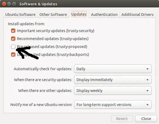

First of all kernel 3.19.0-31 is not available in any Ubuntu stable repositories.
You got it installed because you enabled proposed software source in System Settings -> Software & Updates.
It is not recommended and you did it at your own risk.
You can always boot with a previous kernel using grub menu. Then you can install Synaptic and remove linux-image and linux-headers packages of version 3.19.0-31.
Also I recommend to disable proposed and never enable it unless you know what are you doing!
After you do it make sure that meta-packages linux-image-generic and linux-headers-generic for 15.04 or linux-image-generic-lts-vivid and linux-headers-generic-lts-vivid for 14.04.3 are installed.
Otherwise the kernel will not get normal upgrades.
To get into grub menu you need to hold Shift or Esc at boot depending on your hardware.
