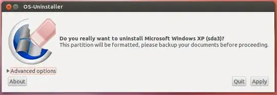

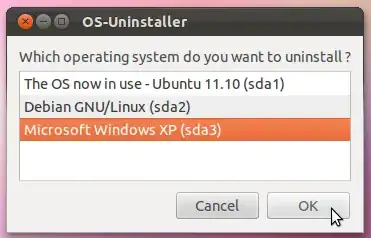

  4. Use os-uninstaller to remove Ubuntu 14.04:
    • launch os-uninstaller from dash
    • choose OS you want to remove and click ok/
    • enter image description here
    • on confirmation window click Apply
Source: OS-Uninstaller
