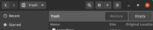

23
Do not forget to Empty Trash.
screenshot
Or from command line:
rm -r ~/.local/share/Trash/info/ && rm -r ~/.local/share/Trash/files/
Or just trash-empty using trash-cli package.
