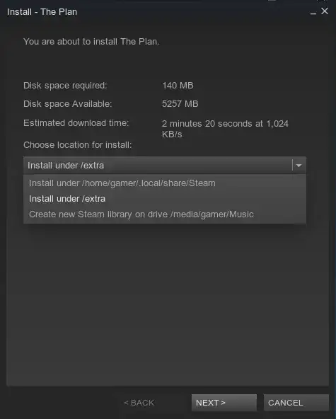

By default Steam stores games in your home directory (hence home partition) under ~/.local/share/Steam, not in the root partition - Steam I don't think is made to have games available system-wide. When you install a game it gives you a option to install it elsewhere:

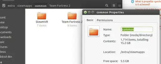

As you can see above, I have created a folder extra in the root partition under which I install steam games that won't fit in my home directory (this folder also means I have somewhere to put stuff if I run out of space on another partition):
enter image description here Here are the commands I created that directory with (you could easily call it something else):
sudo mkdir /extra
sudo chown -R $USER:$USER /extra
The first step creates the directory, the seconds makes sure you can access it as a normal user.
