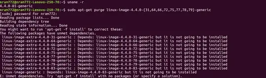

I have been using ubuntu for 3 months now and I have come across this problem. An error message showed up saying
packages with unmet dependencies,update
When i tried to update it says
not enough disk space in /Boot.
I looked up some other answers in this forum and ran the command lines posted there but could'nt solve my problem.
Im pasting my terminal output below.
Ran the apt-get -f install command and got this output.
nram772@nram772-Lenovo-Z50-70:~$ sudo apt-get install -f

dpkg: error processing archive /var/cache/apt/archives/linux-image-4.4.0-83-generic_4.4.0-83.106_amd64.deb (--unpack):
 cannot copy extracted data for './boot/abi-4.4.0-83-generic' to '/boot/abi-4.4.0-83-generic.dpkg-new': failed to write (No space left on device)

This is probably caused by having too many old kernels installed.
If you're happy with your current kernel and want to remove all the older ones, you can use this command to remove all kernels except the currently used one:
sudo dpkg --list | grep linux-image | awk '{ print $2 }' | sort -V | sed -n '/'uname -r'/q;p' | xargs sudo apt-get -y purge
I got this from this answer: https://askubuntu.com/a/254585/19779. I just ran it on my own computer to be sure it works as intended. It freed up 650MB. :)
