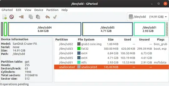

  • Start GParted.
  • Unmount any mounted partitions.
  • Select Device tab and create a GPT partition table on the Target drive.
  • Create a 3GB NTFS or FAT32 partition on the right side, (optional Linux / Windows data partition, See Note 3 at bottom).
  • Create a 1MB partition on the left side, format as unformatted.
  • Create a 300MB FAT32 partition next to the 1MB partition.
  • Create a 7GB ext partition next to the 300MB partition.
  • In the remaining space create an ext4 partition, (optional for /home partition).
  • Apply All Operations.
  • Flag the 1MB partition as bios_grub.
  • Flag the 300MB partition as boot,esp.

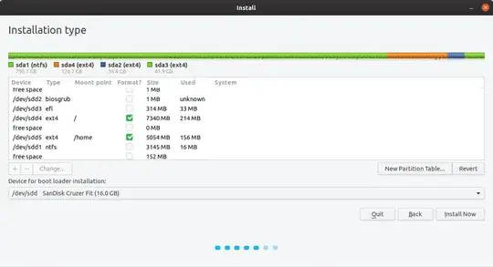

  • Do not use Advanced feature disk encryption for this install method. (See Note 3 at bottom).
  • At "Installation type" select "Something else", click "Continue".
  • Under Device for boot loader installation select the target drive.
  • Select partition sdx4 and click change, select use as Ext4, select format this partition, and Mount point = "/" then OK.
  • If asked to Write previous changes... click Continue.
  • Select partition sdx5 and click change, select use as Ext4, select format this partition, and Mount point = "/home" then OK. (optional).
  • Click Install now.
