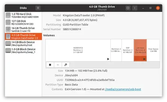

I Flashed https://phillw.net/isos/linux-tools/uefi-n-bios/mkusb_grub-boot-template-for-uefi-n-bios_fat32_4GB_use-in-wins_2020-09-07.img.xz to a 4GB flash drive in Windows using Rufus, in Ubuntu mkusb or Disks will work.
enter image description here I use the FAT32 partition for data
Then I cut the "encrypted" Ubuntu menuentry from grub.cfg on the encrypted drive, (sdc5), and added it to grub.cfg on the external USB drive (sdd4) as the first menuentry.
I have had success booting this drive in BIOS and in UEFI mode.
