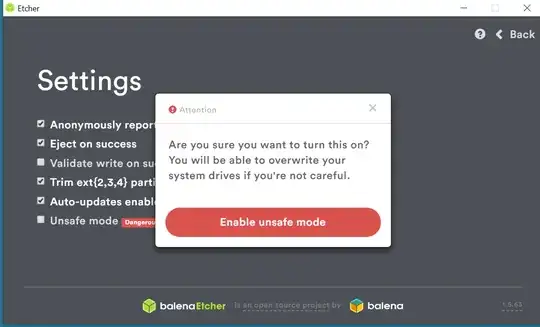

Live External HDD using balenaEtcher
  • Download Etcher: https://www.balena.io/etcher/ , There are Windows and Linux versions available.
  • Double click .exe file to open.
  • Select settings, the cog icon upper right.
  • Check Unsafe mode. This will allow you to overwrite any hard drive on your computer. Be careful an uncheck when done.
  • Select <Back, select your OS image and select your external hard drive.
  • Click Flash. The USB Drive will be overwritten.

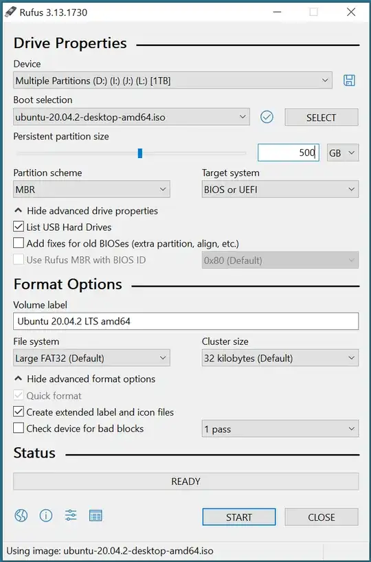

Live External HDD using Rufus
  • Download Rufus: https://rufus.ie/en_US/
  • Check List USB Hard Drives.
  • Select Device, Boot selection, Partition scheme.
  • Select Persistent partition size. I usually leave a bit of space that can be shared with Windows for data.
Click START. The USB Drive will be overwritten.
