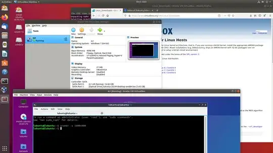

I downloaded a Lubuntu iso file and booted a live session from it in VirtualBox to check that it really works according to these instructions.
Right-click on the screenshot, open in another window and watch it in full screen to see details:
