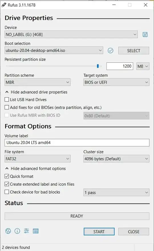

Persistent Install
If you want installed programs on your Live USB to persist from boot to boot, while you are "trying" Ubuntu, you need a "Persistent" install.
Download Ubuntu 20.04 https://ubuntu.com/download/desktop
Start with a USB of at least 3GB formatted FAT32.
If using Windows, download Rufus. https://rufus.ie/
Double click the Rufus .exe file. (No need to install).
Select USB Device and Ubuntu ISO file for Boot Selection.
Confirm Persistent partition slider is almost all the ways to the right, but not quite all the way.
Select
START
When Rufus is done you can use USB to install Ubuntu to BIOS or UEFI machine. Any programs that have been installed on the USB will need to be reinstalled.

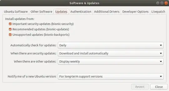

Software & Updates
The software and updated app controls updates.
