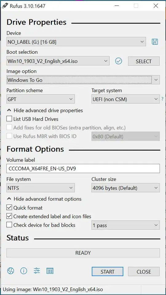

Windows to USB install
Rufus has an option to install Windows to Go to a USB. This is just like running Windows 10 from a hard disk.
It may not work with acceptable speed on all flash drives. It worked good for me on a 64B Lexar.
I will try adding Ubuntu to the disk as dual boot.
