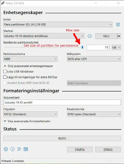

I would recommend the following tools to create a persistent live. If you do it
  • in Windows, you can use Rufus,
  • in Ubuntu, you can use mkusb.
See also this link.
There are instructions at the web sites that I link to.
The original poster, @DreamingOfSleep, was using Rufus, and was helped by the following screenshot, that shows where to set persistence.
Let us hope that it can help other users too.
