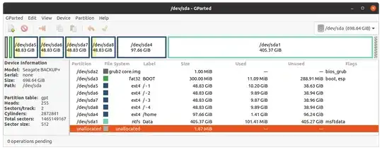

Ubuntu 20.04 USB that boots both BIOS and UEFI with Nvidia, AMD and Standard GPU Drivers. Step by Step
  1. Create Full Install of Ubuntu 20.04 to USB that works in both BIOS and UEFI modes using the procedure at this link: https://askubuntu.com/a/1217839/43926.
  2. Create the Data and two boot partitions as shown. Make the / partition about 20GB. Be sure to use the option for separate /home partition. Make it about 50GB. Leave remaining space empty.
  3. After installation set up OS as desired with all programs and apps needed. Do not install any proprietary graphics drivers.
  4. Boot Live Ubuntu USB, (or GParted USB), and start GParted.
  5. Right click the / partition of the USB and select Copy.
  6. Right click the empty space and select Paste. Repeat to create the third OS partition. Click Apply All Operations.
  7. Expand the NTFS or Fat32 Data partition(s) for sharing with Windows or Apple. Click Apply All Operations.
  8. Right click one of the OS partitions and select New UUID. Repeat to change the next OS partition UUID. Click Apply All Operations.
GParted
  1. Close GParted and reboot.
  2. In Terminal run sudo update-grub.
  3. Open Gnome-Disks and mount the partitions with new UUID's.
  4. Start Nautilus using sudo -H nautilus.
  5. Edit /etc/fstab of each OS partition to change the UUID as shown in Disks.
  6. Edit sdx4 boot/grub/grub.cfg to correct the UUID's on the linux ... lines if needed.
  7. Copy grub.cfg to sdx3 boot/grub/grub.cfg one more time.
  8. Boot each OS and install proprietary GPU drivers as you wish.
  9. Test.
