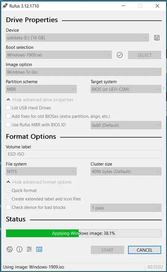

  1. Ventoy will boot the Windows installer ISO. If you want to actually run Windows from USB, Rufus has an option to install Windows to Go. it takes hours and hours to install.

  • Use Rufus to install Windows to Go. This is a very slow process and may take overnight.

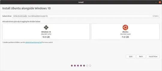

  • Use a Ubuntu Live pendrive to install Ubuntu alongside Windows on the USB, in the same BIOS/UEFI mode as Windows.
